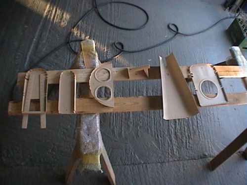

(1) I went for a 2 pack epoxy primer over the etch primer for the aftmost components, as this is likely to be where any water will collect and drain to, being a tail wheel aircraft.
Priming the aft bulkhead parts
