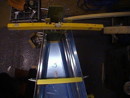

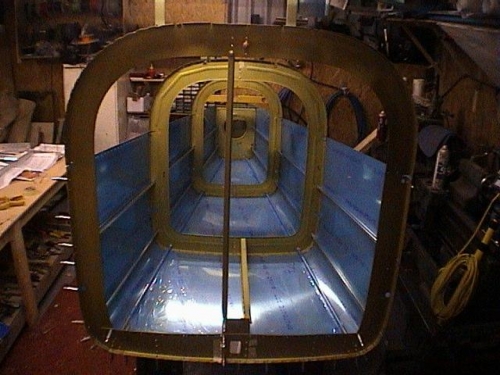

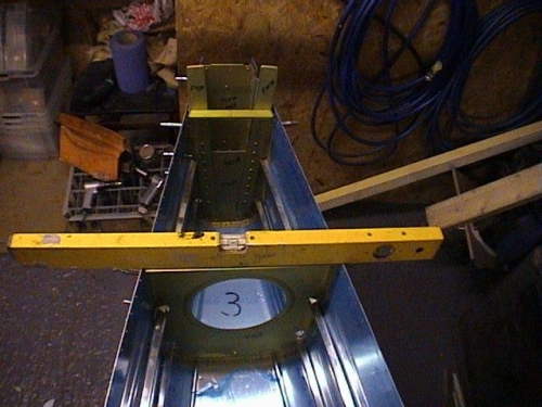

Once the tailskins and bulkheads have been clecoed together, the tailcone needs sitting on trestles and checking for level and twist.
Checking for twist
