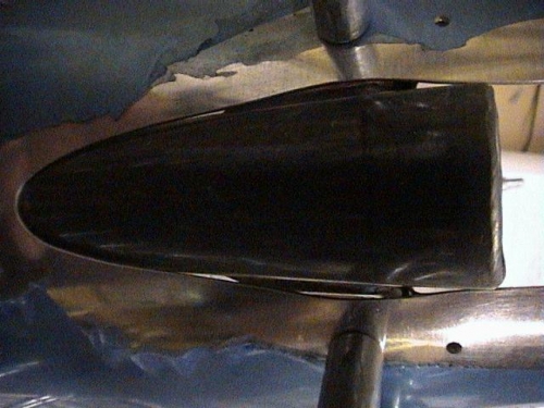

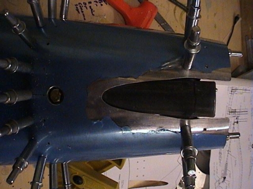

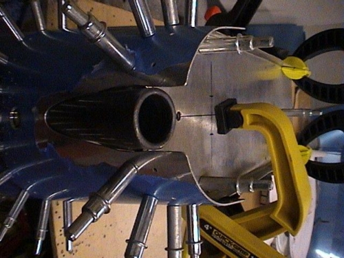

(1) After fitting the rearmost bulkheads and tailwheel mount and skin, the exit hole needs cutting to suit. Make sure there is no chaffing here as the tail wheel mount is steel and will soon rust once the primer is rubbed away.
