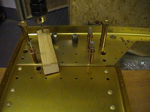

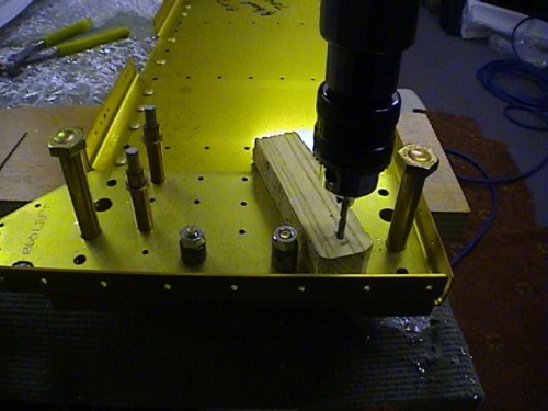

Brief Description:  Centre section/Fuse kit arrives
Whilst waiting for the fuse kit to arrive, I started work on the centre section.(1/2) This block of hardwood was first pre drilled on the drill press; the drill is then guided through the spacers at 90 degrees to the web.(3) Fuse kit arrives.
