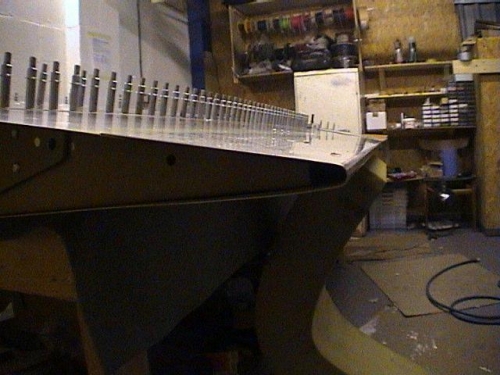

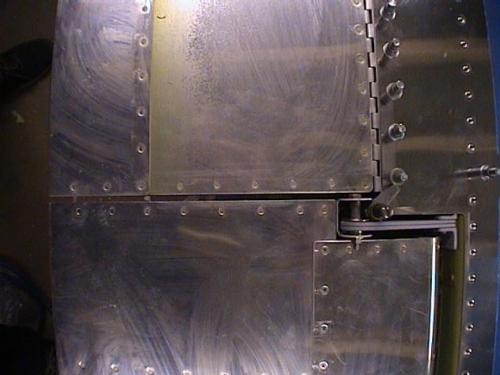

Brief Description:  Aligning ailerons and flaps
One pet hate of mine is crooked number plates on new cars and, looking at a couple of finished RVs as a new builder often does, something really stood out. That was staggered trailing edges of flaps in relation to ailerons and uneven gap between the two inboard ends. From the outset I was determined to get this as near perfect as I could.
