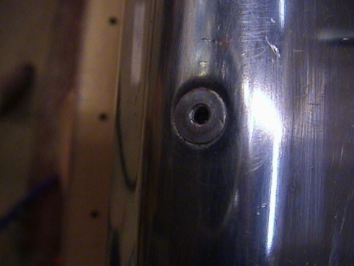

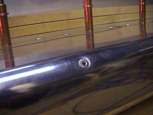

Manual Reference:  W24
Brief Description:  Ailerons
(3) I found this to be the easiest way to rivet the skin to the top edge of the spar. Clamp the aileron to the bench with the spar overhanging the edge, pull back the skin and secure with duct/gaffer tape. It is then easy to hold a dolly against the rear face of the spar whilst using the rivet gun upwards from underneath.
