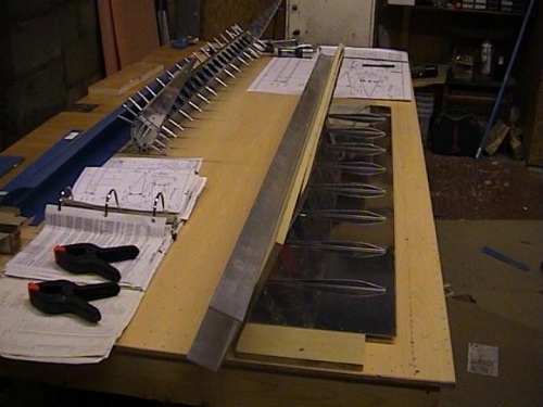

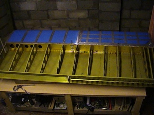

Fitting the flap brace and aileron gap fairing.I made a bending brake from a heavy piece of ally channel, a couple of pieces of MDF and a length of piano hinge, to fold the trailing edge of the ailerons.
Starting the fold, stiffeners in place
Completing the fold
Completing the fold
