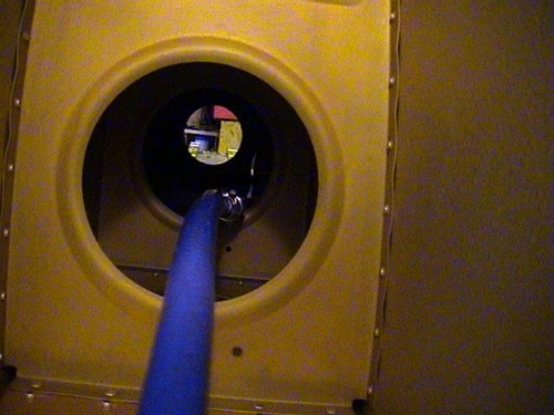

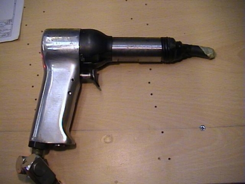

Riveting leading edge in place
(1) I removed the set retaining spring and used self amalgamating rubber tape instead (also around airline fitting), whilst using the gun in the confines of the leading edge.(3) Holding the gun like this may look awkward but it worked for me.
Gun adapted for the confines of the leading edges
Holding rivet gun through access hole
