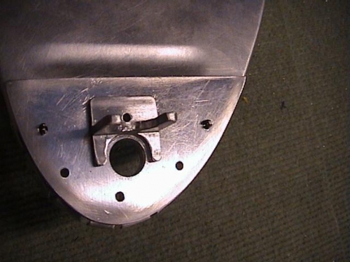

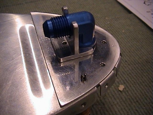

Date:  12-17-2004
Number of Hours:  10.00
Manual Reference:  W13a
Brief Description:  Fuel tank
On the starboard tank i have gone for the inverted (flop tube) fuel pickup, but unlike the standard pickup which has an anti rotation bracket, none was stipulated for this fitting. I had concerns that while tightening and slackening the fuel pipe this fitting could rotate, preventing the flop tube working correctly and breaking the seal. The solution was to fabricate this bracket from T extrusion
