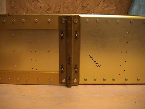

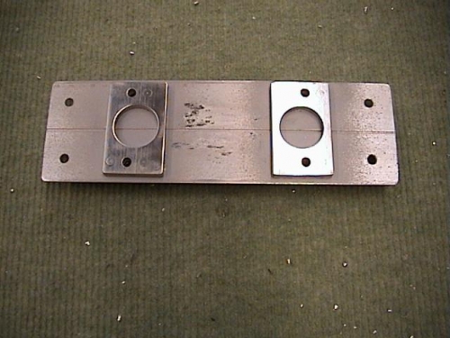

Wing tie down anchors
Make sure you hold the spacers nice and tight when drilling through everything or they will move. I ended up making another one.
Spacers for tie down also get the litened

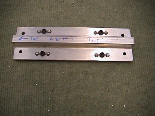

Nut plates rivetted
Tie down etch primed and bolted to spar
