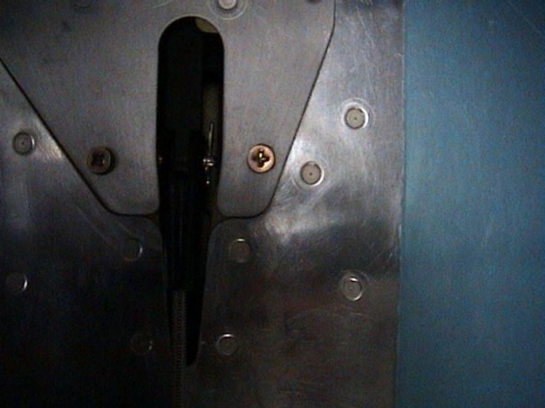

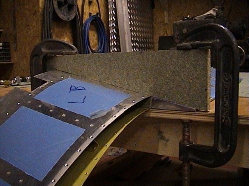

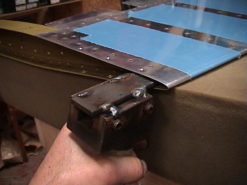

(1) Homemade male/female former made from chip board used for bending trim tab opening.(2) Be careful mounting trim actuator! Wrong drawing callouts caused rod to exit off centre, had to make new plate.(3) Homemade dolly makes it possible to fit solid rivets in tight skin bend.
Homemade former male and female
Electric trim servo motor installation
Homemade dolly
Homemade dolly
