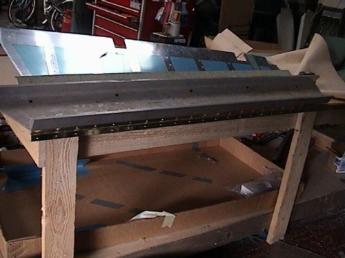

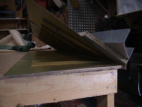

(1) These trailing edge rivets have to be double flush. This is a shot of the worked side of the rivets.(2) This homemade folder is made from a heavy piece of ally channel, a length of chipboard and a piece of piano hinge fastened to the bench.
