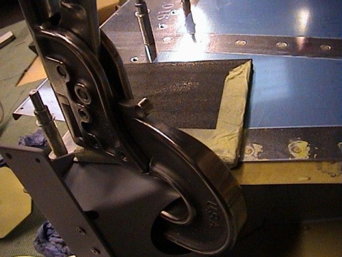

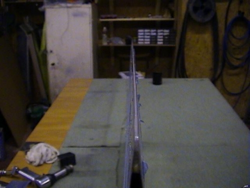

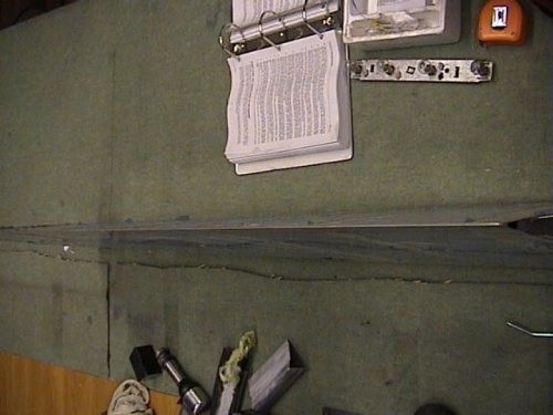

Brief Description:  Rudder
(1) These are supposed to be inferior blind rivets but with a little ingenuity you can get the squeezer in there and use much stronger solid rivets instead.(2) Getting a dead straight trailing edge to the rudder is tricky. I found the easiest way was to use a 2 pack epoxy and some weights on a flat work bench before rivetting.(3) Results- spot on.
