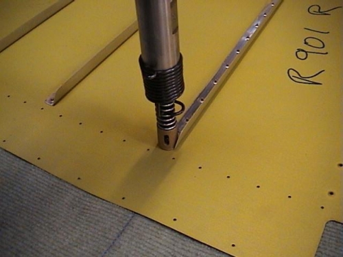

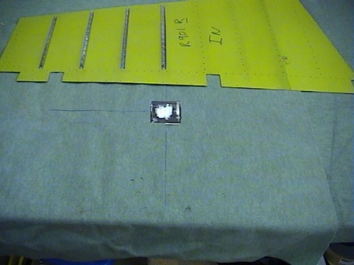

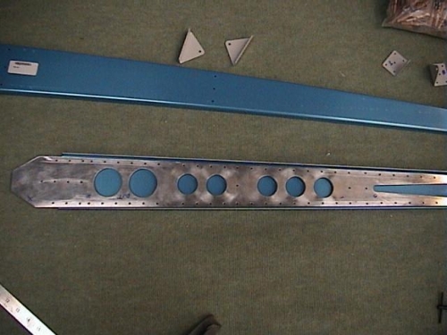

Brief Description:  Vertical stabiliser and stiffeners
(1) Lightening holes, more polishing and priming.(2) Setting this plate in the workbench made it easy to (3) back rivet the stiffeners to the vertical stab skin. Removable carpet protects the soft alclad from scratches. The yellow etch primer is very thin and difficult to apply but the finish is excellent and the colour matches the factory gold anodising quite well.
Vertical stab spar

Back rivettng stiffeners
