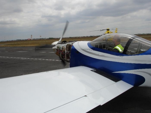

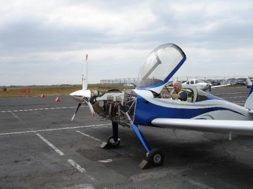

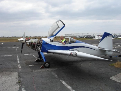

Removed the lower plugs and pulled the prop through to get rid of the inhibiting oil. Put in some straight oil and turned the engine over until I had oil at the oil pressure switch. Moved the plane out of the hanger and chocked the wheels. Put some fuel in the left tank, primed the system and started her up, she ran great.
