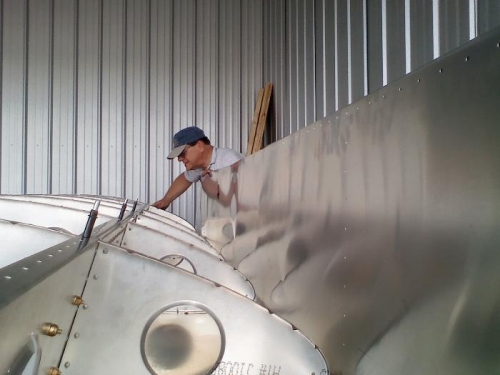

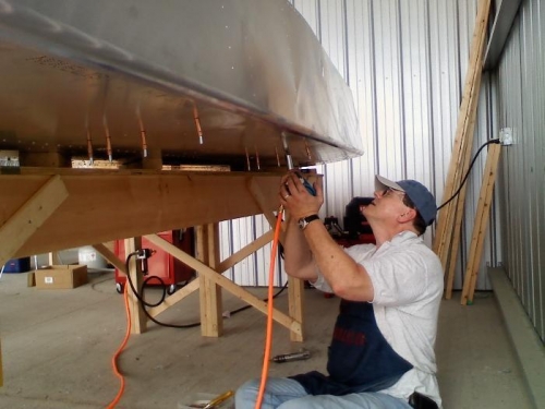

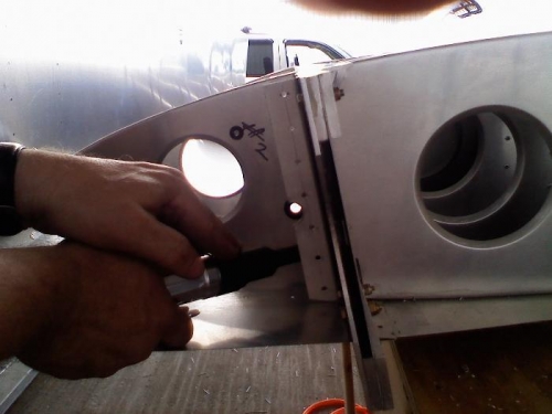

riveted front spar back onto rear ribs.
riveted nose ribs back onto upgraded front spar.
ligned up and clecoed nose skin to wing.
finished installing "L" angle between nose rib #1 and nose Rib #2 per upgrade kit.
Drilled additional holes in bottom of front spar from inboard to rear rib # 5 in front spar per upgrade drawings.
Deburred new holes and riveted bottom of nose skin onto right wing.
