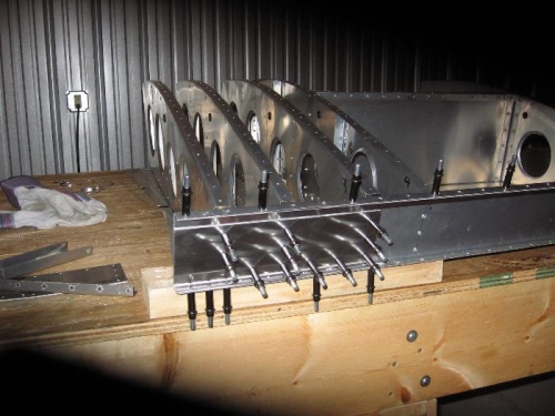

Manual Reference:  Right Wing
Brief Description:  Right Wing upgrade

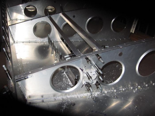

Finished drilling and positioning Bell Crank support.
positioned and drilled rear spar doubler for inboard mount to airframe.
positioned and drilled doubler for Aileron control arm.
Positioned and started drilling the top rear spar doubler.
This is all to comply with the FAA SAIB CE-10-08
