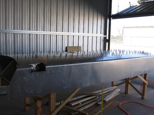

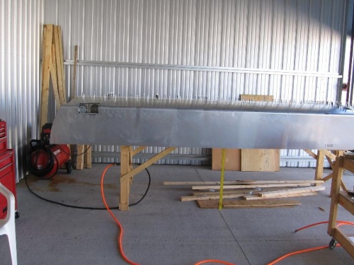

Manual Reference:  Left Wing
Brief Description:  Nose Skin
pre cut opening in nose skin for landing lights.
finished pre-drilling holes in nose ribs and pre-drilled additional holes for SAIB upgrade in main wing spar from inboard edge to # 5 rear rib.
drilled all holes to size.
Do not drill holes to landing light assembly until top of nos skin is drilled and clecoed in place.
