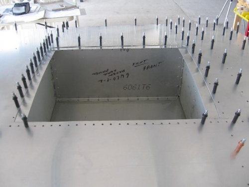

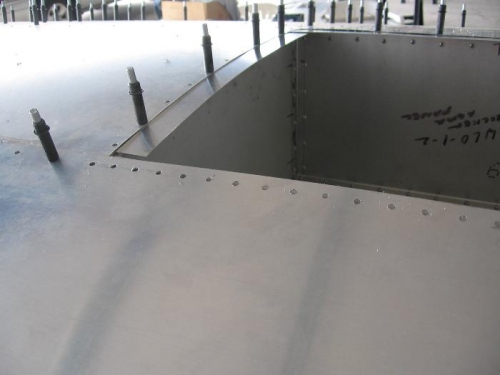

Manual Reference:  Right Wing
Brief Description:  Wing Locker
Due to SAIB CE_10_08 the original Wing Locker Cover no longer would fit to existing holes and cover would not open and close properly so I had to get new Dzus strips and Cover and Re-deswign the wqy the cover will work.
Drilled Dzus strips to existing holes in wings.
Cut Piano hinge to length of cover and drilled hinge to existing holes in wing.
