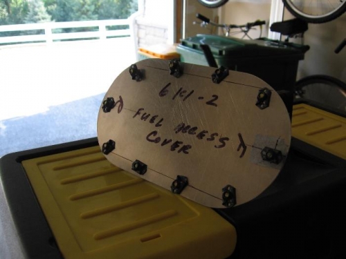

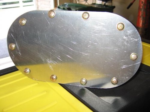

Access plate came as a rectangular piece of aluminum. cut out shape per plans and drilled the skin and plate to 7/32" for screws and nut plates.
Nut plates still need to be drilled and riveted.
inside of access plate
outside of access plate
