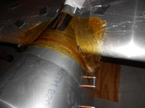

Preped top rear of fuselage for making fiberglass fairing.
cut fiberglass material.
Mixed resin, and wet cloth.
laid and smoothed cloth using fuselage as a mold.

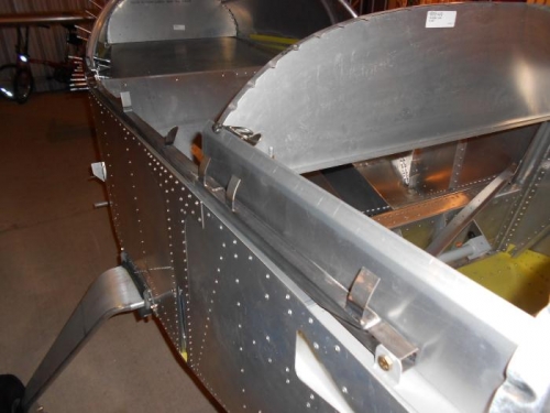

Lined up parts for installation of canopy rails.
Bent canopy rails to conform to shape of side of fuselage per photo assembly guide.

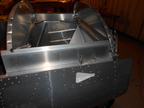

Started filing and deburring parts that support turtle deck top skin so they can be rivited in place.
