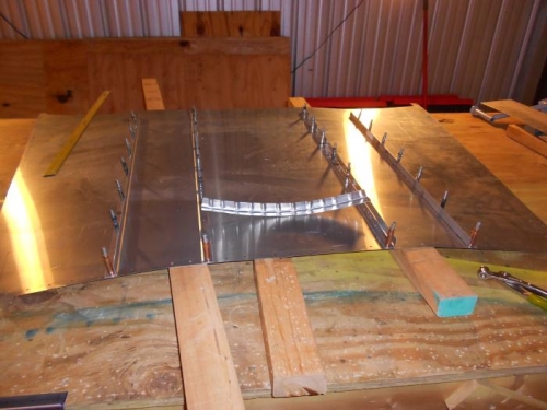

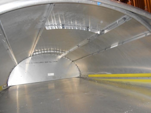

Did a final trim of the rear and front of the top front skin.
Cut 6 "L" angles to length.
Mark and pre-drill "L" angles per plans.
Create the curves in the front and rear "L" angles to match arc of front skin.
Pre-drill "L" angles to front top skin.

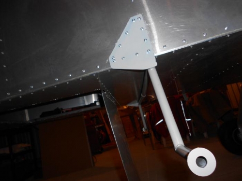

Measure and Pre-drill mounts for steps to airframe.
final drill mounts for steps to airframe.
De-burr, file and round corners for step mounts.
Apply anti corrosion and allow to dry.
Rivet steps to airframe.
