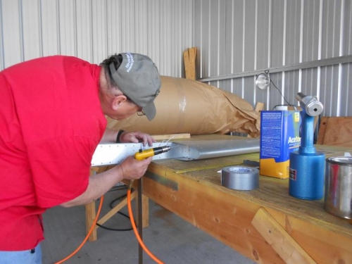

Positioned and driled lower and upper bearings to rudder.
Deburred bearings, applied anti corrosion and riveted to rudder.
Started drilling fairing to rudder, however, when tried to fit to fuselage, fairing was rubbing fuselage rear skins. ttrimed fairing smaller and re-drilled but bottom was clear but top was still rubbing skins. Tried to trim on an angle to allow for wider bottom and narrower upper area of rudder however the fairing got too small.
Need to order a new peice of metal and start over.
