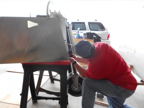

Brief Description:  Attached Landing gear
Attached main gear to fuselage.
Chris Mate installed hardware and started bolts while I held main spring gear up.
GTorqued main gear bolts.
Installed nose gear.
Drilled holes for cotter pins in main gear bolts to lock castle nuts.
Installed cotter pins.
