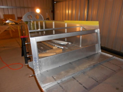

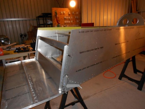

Brief Description:  debur & assemble rear thru spar
Continued deburring forward fuselage.

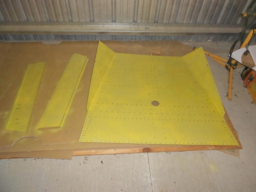

coated cabin floor with Zinc Chromite for anti corrosion protection.
used Cortec on rear thru spar parts for anti corrosion protection.
assembled rear thru spar parts and bolted and riveted together and positiond back in rear fuselage and rivited in place.
