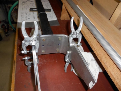

Using drill press at home;
drilled nose wheel fork (2 parts) to nose wheel strut.
measured and drilled 2 holes on each side to tie 2 fork parts together per plans.

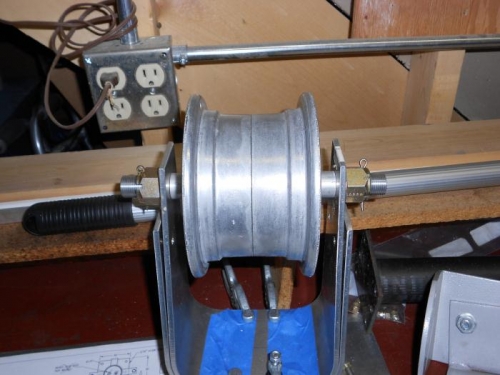

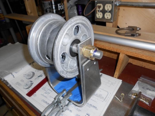

Drilled 3/4" hole on both sides of fork for axle.
Drilled 2 holes through axle for cotter pins to lock castle nuts.
