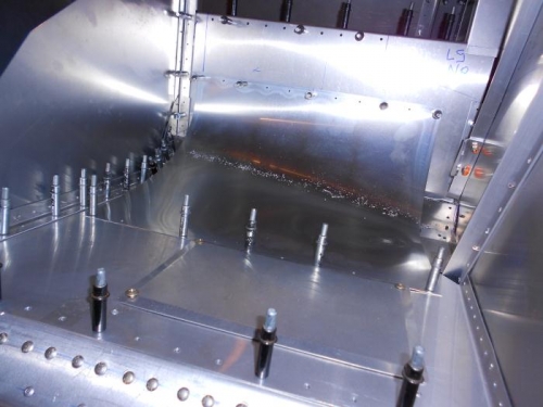

Manual Reference:  Pilots Seat
Brief Description:  Assemble and install Pilot Seat
Cut "L" Angles including the .040" Thick "L" Angles per SAIB CE_10_08 to fit seat along side armrest on left side.
Drilled and clecoed "L" angles, armrest side and seat along with seatbelt attachment.
Insalled seat and drilled to airframe.
Lined up and drilled seat bottom to seat front a d seat back.
Drilled and installed gusset for flap motor mount.
drilled flap motor mount thru gusset and rear of back of seat.
