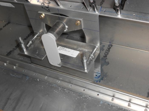

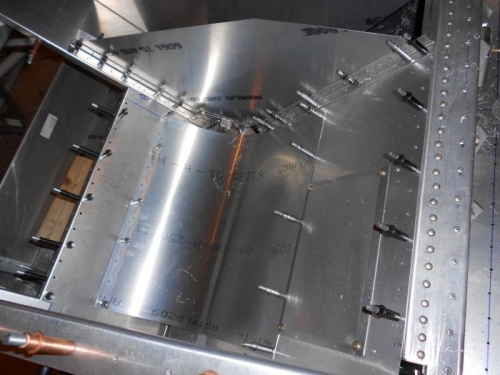

Drilled the upper front longeron caps into upper longeron.
Positioned and drilled aleron stop into position per SAIB CE_10_08.
Cut the standard "L" Angles and the .040 thick "L" angles to size per SAIB CE_10_08 for right seat arm rest.
Drilled the "L" angles along with the seat belt attachment to the right seat arm rest side.
Drilled right seat arm rest to airframe.
Positioned Right seat bottom and drilled to front of seat bottom and back of seat per plans.
