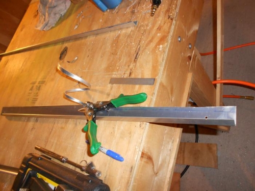

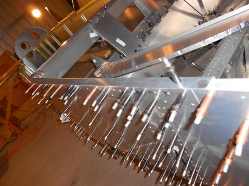

Trimmed upper longeron front caps to fit side of fuselage.
Layed out rivet line and predrilled caps.

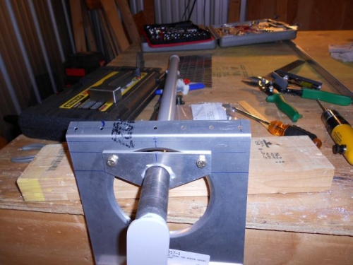

lined up, drilled and bolted torque tube rear bearing to rear bearing support.
Cut front torque tube bearing to properly align with main through spar.
Leveled torqe tube and drilled front torque tube bearing to front of main through spar.
Bolted front torque tube bearing to main through spar.
Cut to shape the seat belt attach plates.
Drilled hole for seat belt bolts.
Drilled and bolted to fuselage upright per plans.
