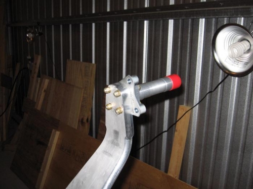

Fit axles to main spring gear and clamped in place.
Used a transfer punch to mark four holes for each axle to main spring gear.
drilled 4 holes for mounting axles to main spring gear on left and right side.
Rounded corners on bottom of landing gear.
checked fit of brakes and bolted brake mount plate and axles to main spring gear.

Bolted axle to main spring gear
