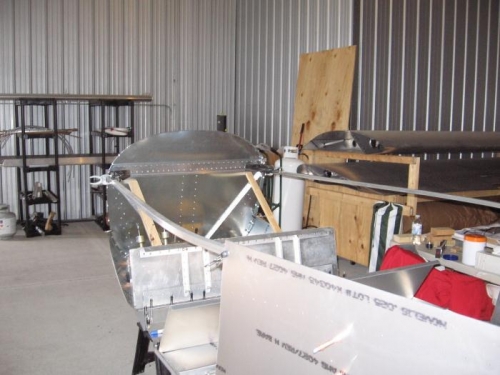

Placed the top front longerons and got them level with firewall elevated 42 MM and firewall on a 77 degree angle per plans and builders guide.

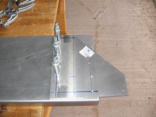

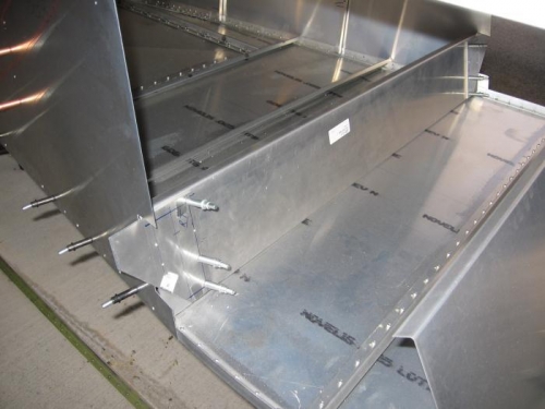

Drilled the upgraded rearspar attach plates to the main rear spar per SAIB CE-10-08.
cut the rear side skins for the rear spar attach plates.
Top Front longerons leveled
Rear spar attach plate
Main rear spar
Main rear spar
