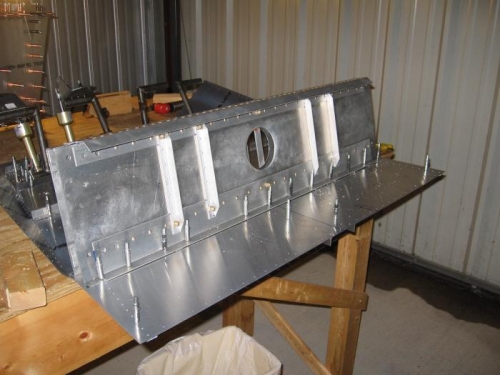

Manual Reference:  Main Spar
Brief Description:  Main spar / upgrade SAIB CE_10_08

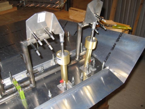

Finished drilling brake cylinder supports and inserted brake cylinders to ensure fit and travel.

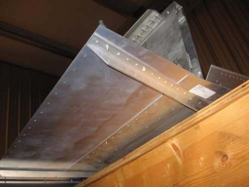

Predrilled main spar to cabin floor.
predrilled cabin floor spar doubler to bottom of cabin floor per instructions and updated plans from SAIB CE_10_08.
