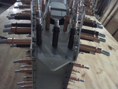

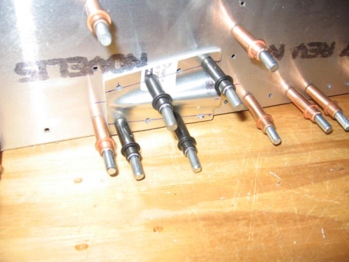

installed the left fairing for the rudder control cable.
Lined up and drilled to size upper rudder hinge.
Trimmed the landing gear channel on both sides per plans.
Predrilled landing gear channel to bottom of rear fuselage.
Predrilled the rear seat support to the bottom of the rear fuselage.
Drilled the landing gear channel and the rearseat support holes to final size for A5 rivets.
