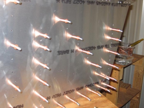

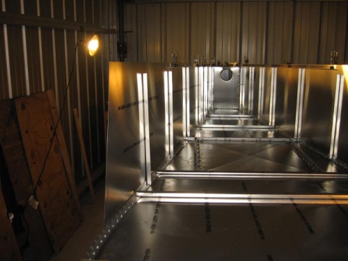

joggled "L" angles for upright support of right side rear of fuselage.
Drilled and clecoed right side sheet to bottom rear stringer.

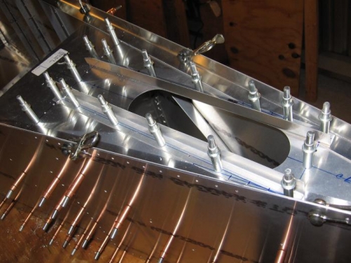

drilled and clecoed horizontal tail to right and left side sheets.
Cut "L" angle to length and dilled and clecoed to an angle between the 2 H. T.
lined up and pre drilled part # 6B3-6/1 to 2 H. T.
Cut 2 "L" angles and pre drilled to part # 6B3-6/1.
