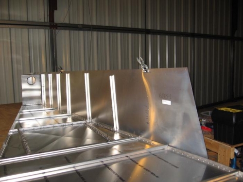

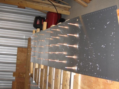

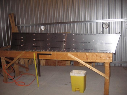

drilled and clecoed "L" angles to right side rear skin.
Trimmed "L" angles to length per plans.
Lined up left rear skin to bottom rear fuselage.
toggled bottom ends of "L" angles.
drilled and clecoed left rear skin to fuselage bottom.
