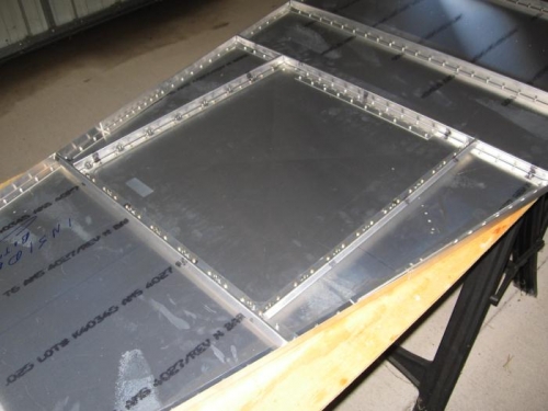

Access Door

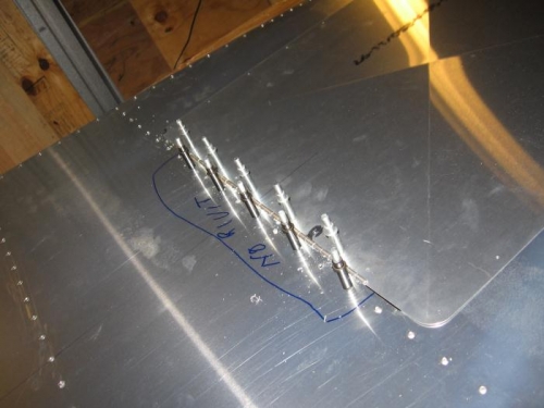

Used solid flush Rivets where cover overlaps skin.
Pre drilled hinge to door and to bottom of fuselage.
Drilled holes for screws and nut plates andriveted nut plates to fuselage skin.Drilled all to size, and riveted together.
