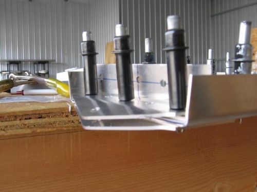

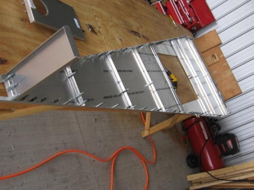

Made the2 spacers for joining the front and rear bottom longerons.
Finished predrilling the longerons to the bottom skin.
Toggled the ends of the "Z" and "L" angles to go over the bottom longerons.
Drilled and trimmed parts as necessaru for the bottom rudder hinge.
Bottom Longerons Predrilled
"Z" angle toggled over longeron
