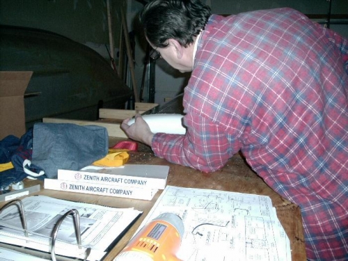

Brief Description:  fitted & drilled Fiberglass tips
Used heat gun to warm fiberglass stabilizer tips & worked them with my hands to get them to fit to the shape & size of the stabilizer. Chris Mate helped by holding stabilizer tips in place as I started drilling & clecoing to the stabilizer. Drilled & clecoed them to the stabilizer. Assembly manual states do not rivit until after the stabilizer is mounted to the fusalage.
