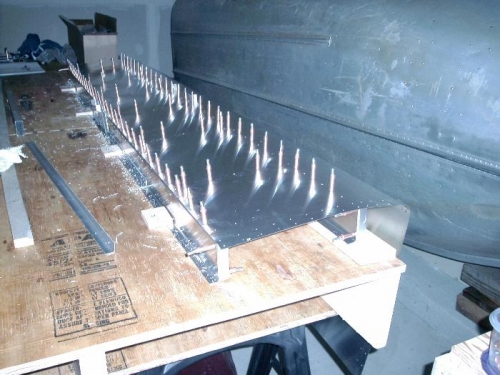

Working on the skin
Set up the jigs to hold the skeleton square & level. Lined up & fitted the skin to the bottom of the Sabilizer. Drilled & Clecoed all holes in spars & ribs on bottom side.
