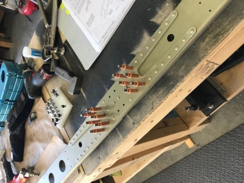

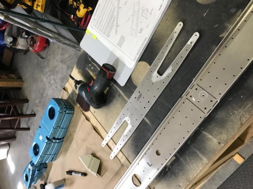

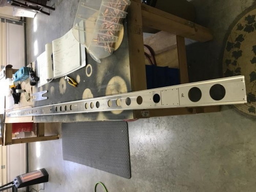

Deburred, drilled and primed HS rear spar and spar doubler. Countersunk center 2 doubler rivet holes to allow clearance for IB hinge bracket assembly. Riveted rear spar doubler to spar.
