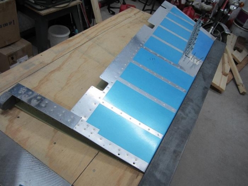

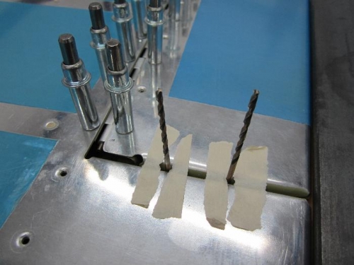

I aligned and match drilled #40 the forward portion of E-721 using the holes in E-701-L and E-606PP as a drill guide. I used the long piece of 1/4" steel I used as my bucking bar to back rivet the rudder as a straight edge to make sure the elevator and tab aligned evenly. I also used a couple of #40 drill bits in between the elevator and trim tab to give me the proper spacing between those two components. I used a cleco clamp to hold the hinge on the inboard side and worked my way outward drilling holes and it turned out very well.

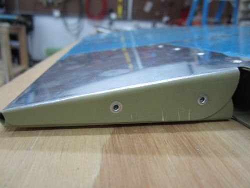

Flush Pop rivets in left elevator.
Aligning trim tab with left elevator.
I used my 1/4
I used my 1/4" rivet bar as my straight edge.
