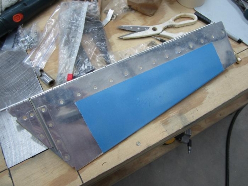

Brief Description:  Started Riveting Left Elevator Trim Tab
Today I riveted the bottom of E-619-1-020 trim tab skin to the bottom flange of E-607PP trim tab spar, E-717 and E-718 trim tab horns. I used my pneumatic squeezer equipped with longeron yoke and different thicknesses of flat sets. This was no easy feat and took a little while to get one row of rivets set.
Bottom rivets set.
Bottom rivets set.
Trim tab control horns installed.
