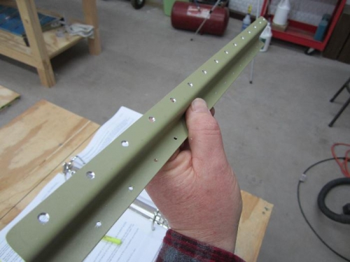

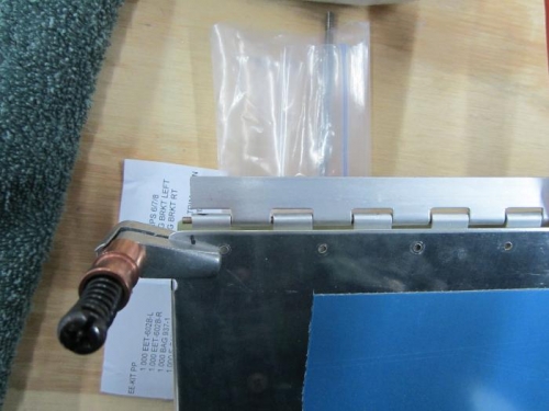

To prepare the hinge for drilling, I measured and drew al line down the middle of the trailing portion of the hinge so I could see it through the holes in the trim tab skin for drilling. After that I disassemble, deburred, countersunk the top holes of the trim spar to accept the dimples from the skin and dimpled all the necessary holes in the skin, spar and servo arms. All I need to do now is trim the edge of the hinge and drill the folded tabs on the ends for rivets.
You can see the drill line through the holes.
Top holes of E-607 trim tab spar countersunk.
Everything lines up nicely.
