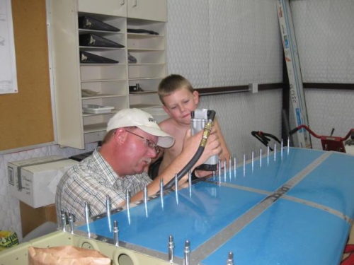

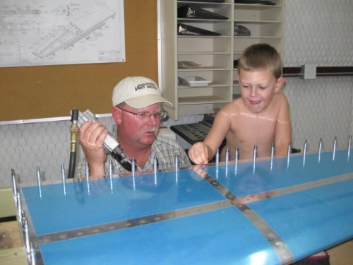

Brief Description:  Finished Horizontal Stabilizer
I had some help today finishing up the horizontal stabilizer. Eric would put a rivet in and I would squeeze it with the pneumatic riveter. All the rivets were easily accessible using the three inch yoke, four inch no hole yoke and the longeron yoke in the squeezer depending on where I needed to use them. I riveted the rear spar assembly, HS-404, HS-405 and HS-706 to HS-601PP. Then blind riveted the rear spar assembly to HS-708.
