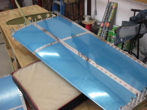

Brief Description:  Riveting Left HS Skin
I clecoed the forward spar assembly to HS-706, HS-707 and HS-601PP, then clecoed on HS-708 like the plans said. The plans then say to blind rivet HS-702 to HS-707 and HS-708 right before riveting HS-702 to HS-706, but I'm here to tell you that if you do it like that you won't be able to squeeze any rivets into HS-702 to HS-706, you could buck the rivets but not squeeze them. I had to uncleco most of it to first squeeze rivets into HS-702(front spar) to HS-706(outer most rib) before putting blind rivets into HS-702 to HS-707 and HS-708(middle ribs). Then it was off to the races with bucking rivets. I bucked all the top and bottom rivets on the left horizontal stabilizer that cannot be squeezed and prepared the right horizontal stabilizer for my next riveting session.
Riveted Top Left HS

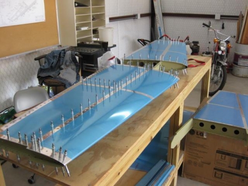

Flipped and Riveted Lower Left HS

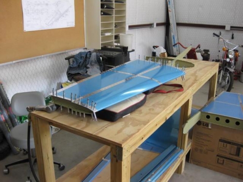

Right HS Ready for Rivets
