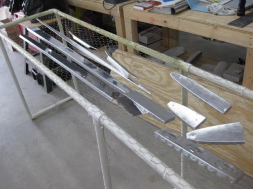

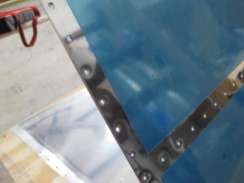

Deburred the left horizontal stabilizer skin and dimpled it as well as the skeleton. I used the tank dimple dies for the understructure. I also remembered not to dimple the holes in the skin and inner ribs that will be used to attach the empennage fairing at a later time. After I finished with that I gave everything a good cleaning with MEK to clean off all markings and air tool oil.
Left HS ribs dimpled
Circled holes that don't get dimpled
