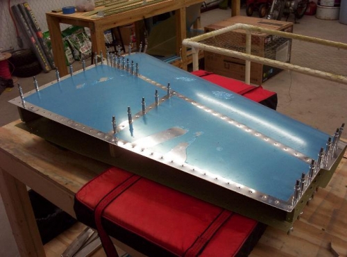

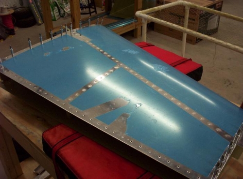

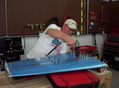

Brief Description:  Riveting Vertical Stabilizer Left Side
As per the plans, I started riveting at the intersection of the VS-707 and VS-702 and worked towards the tip of the vertical stabilizer. I then restarted at the same place and riveted along the front spar toward the root and along the VS-707 rib from front toward the rear spar. There was easy access to allow me to buck and rivet by myself. I used two seat pads to hold the VS up off the bench so the clecos on the bottom wouldn't end up damaging the skin while I riveted the top.
