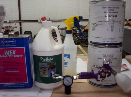

Date:  5-26-2011
Number of Hours:  0.75
Manual Reference:  6-3
Brief Description:  Cleaning Right Horizontal Stabilizer
Today I used MEK to clean any air tool oil off of all the right horizontal stabilizer parts. Make sure you wear a respirator when working with MEK because it is some pretty wicked stuff to breathe in. I have deciced on my method of priming. After everything is cleaned with MEK, I will scrub all the parts down with Prekote and then prime with AKZO.
Priming System
Priming System
