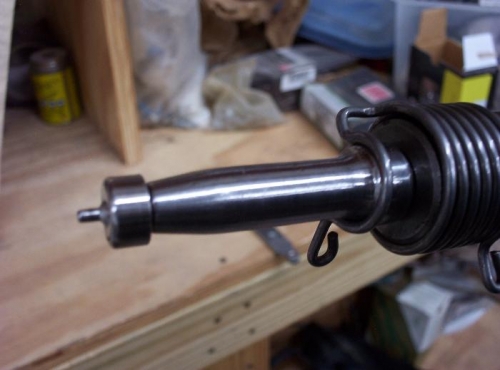

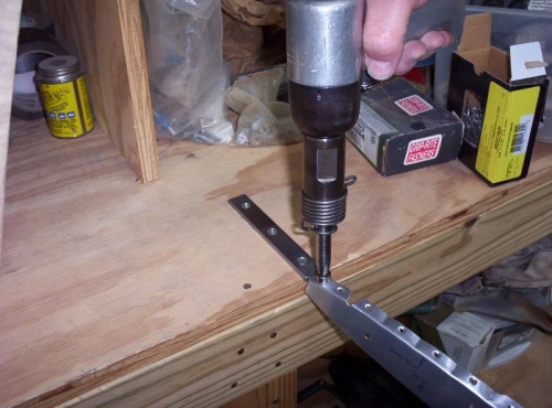

I couldn't squeeze dimple some of the holes in the forward ribs so I bought a neat little tool with a female dimple die that you attach to a work surface and then used the rivet gun to hammer a dimple in with a male die that I attached to an old rivet set that I drilled out. After I made my dimples I couldn't get the male die out, so I had to order a new dimple die. At least I will get to use this tool a bit more so no big woop.

My home made male dimpler
This makes things easier
