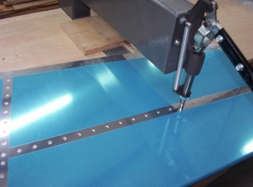

Took the right horizontal skin off and removed the plastic over the rivet holes with the hot iron and deburred all of the holes. Next I scuffed over the inside holes with a scotch brite pad and dimpled all but the top 5 inboard holes that will be used later to attach the empennage fairing.
Squeeze Dimpling the Outer Holes

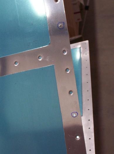

Marked the top 5 inboard holes that don't get dimpled
